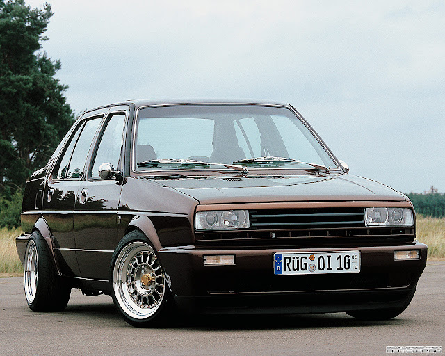

Rozważania na temat koloru
http://lh5.ggpht.com/TehLonz/Ro2FI3Fcmw ... ta_2_1.jpg" onclick="window.open(this.href);return false;
lub
lub
http://i104.photobucket.com/albums/m182 ... jeffb2.jpg" onclick="window.open(this.href);return false;
